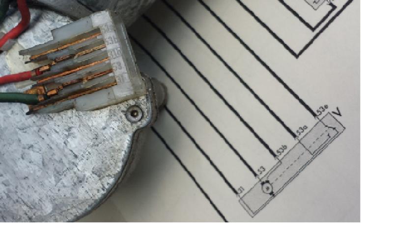

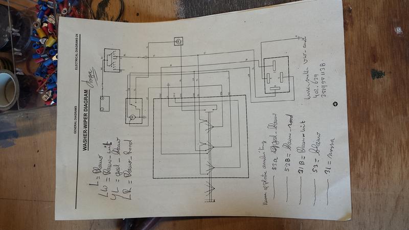

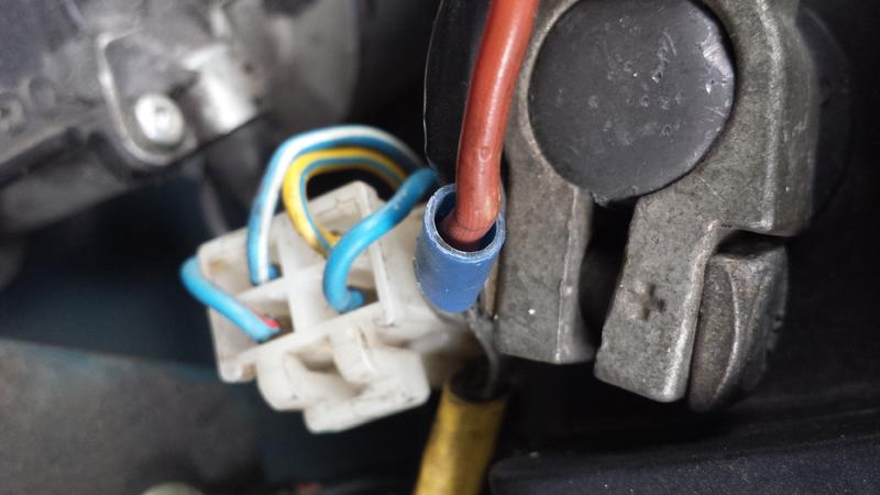

Hi, I didn't quite understand the color of the wires. So I had to work hard rotfl and finally got it to work. YES
I used the wiper motor: 1C0 955 119
(GOLF3,4;OCTAVIA1,LEON1,TOLEDO2,CADDY2,PASSATB3/4,TRANSPORTER4etc)
WIPER CONECTOR - SANTANA WIRES
1 - GND (minus pole)
2 - BLUE/RED
3 - BLUE/WHITE
4 - BLUE
5 - YELLOW/BLUE
Unfortunately this motor is single speed only. The second and third stages therefore run at the same speed. Default position works, cycler. Considering the price of about 18 euros, it is a very cheap and functional replacement.
I hope the pictures last a long time.
Good luck
