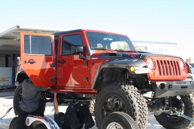

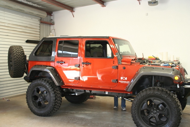

Gebaut für die SEMA 2008 von www.cop4x4.com
http://www.cop4x4.com/orangeCrush/orangeCrush.shtml
Build Thread: http://www.jk-forum.com/showthread.php?t=54134
Motor and Drivetrain:
•7.0 Liter 426c” 655hp custom built hemi
•228/232 565/565 115LSA 111ICL
•Stage 2 Heads
•2.10/1.60 Stainless Valves
•Titanium Retainers
•Manley Springs
•Custom Locators
•Machined Locks
•Bronze Guides
•Viton Valve Seals
•CNC Ported/Hand Finished
•Billet Throttle Body
•545RFE Tyranny
•Larger custom Radiator/ fans/ ect.
•Currie Front Dana 60
•Currie Rear Dana 60
•513 gears
•Custom Heavy duty drive shafts
•SRT8 6 piston front Brakes and rotors
•Polished intake
•Custom Valve covers
•TeraFlex 6" Long Arm Lift
•Walker Evans 12” travel shocks
•2” airbags
•2” Wheel spacers
•6 lug axels
•Empire 22” black rims with orange inserts and carbon insert plates ½1/2” KMC
•40” Toyo MT’s
Outside Mods:
•Bushwacker fenders out of Carbon Fiber
•Entire Wild Boar Slant Back Carbon fiber
•TMD Custom Hood w/ Carbon vents
•Carbon Windshield pillars
•Anodized Black Billet Door Hinges, Door Handles, Hood latches, Antenna surround, front and side light covers, cop4x4 badge
•Custom painted hood with Orange Crush logo, tail lights, mirrors, plate holder, and all plastic
•Shaved Door Locks
•Mirror Mods?
•Stubby Antenna
•In Fab Custom Side steps
•TeraFlex Front and Rear Bumper/Tire Carrier, Glass Painted
•Vision X 84 LED 42” light bar carbon
Interior Mods:
•Custom Dash with Carbon accents
•Black/carbon door panels
•Custom Speaker Bar
•Pop up DVD/NAV/DC with amp, new speakers
•Headrest TV’s
•Black seats with orange suede insert
•Black headliner with orange suede panels
•Custom Arm Rest, Grab Bar, door pulls.
•Black billet shifters, seat adjusters, climate control knobs, air vents
•Carbon gage pod with gages
•Carbon Surf Board
