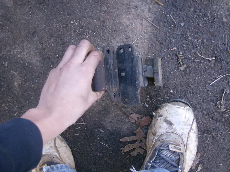

BeitragVerfasst am: 04.02.2007 02:06:05    Titel:
Got some pics.

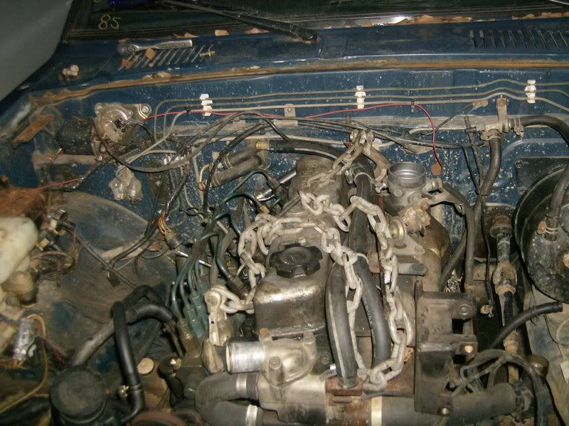

Motor mounts, diesel mount on the left. The mounts did not bolt up, neither did the gas mounts bolt to the holes there needed to be in. I had to grind off the alingment tabs and elongate one of the holes with the plasma cutter.

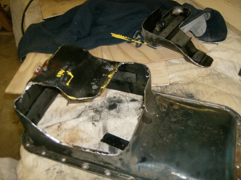

I finally got the motor in place after that, without the oil pan of couse. I then started making measurements to see what I will need to take out of the stock oil pan.
Then I cut the oilpan to pieces. I need to remove the motor again to check the oilpan and make a few more measurements. Then I will braze some sheet metal back to it. So far I plan on not having to modify the pick-up.

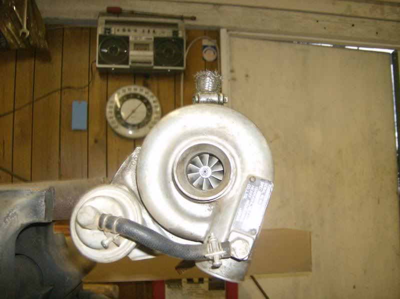

and a quick pic of the turbo that will go on here as soon as I get the oil pan done.
