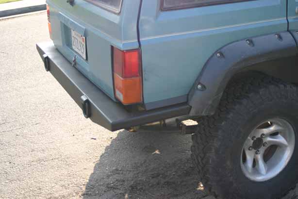

http://www.bakersfieldtrailblazers.org/XJ_BUMPER/jeep_xj_rear_bumper.htm
