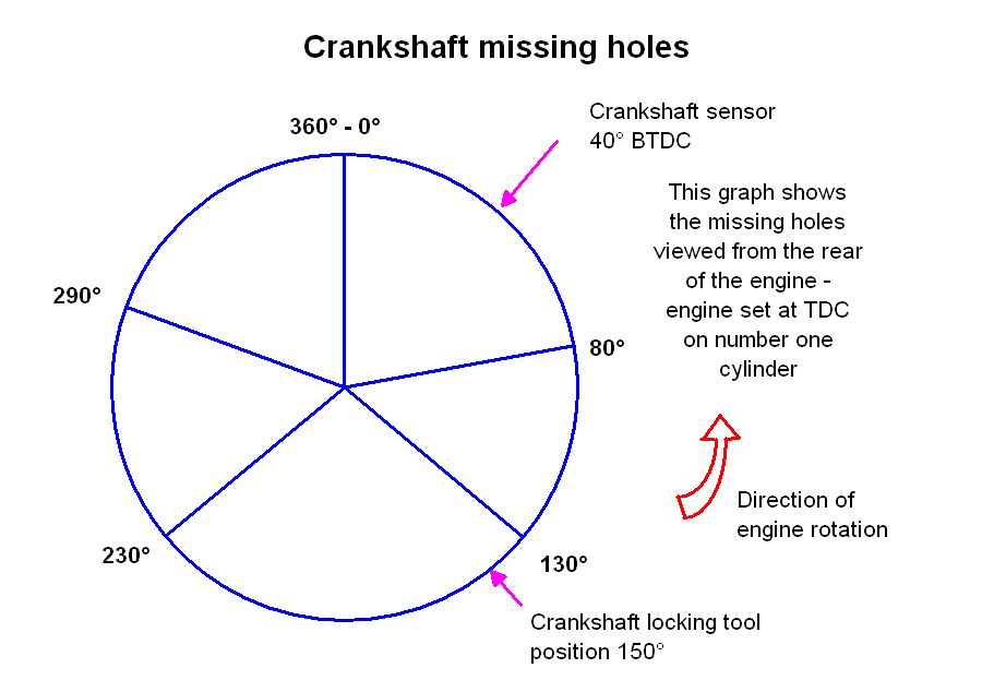

This will help you, it's from a technical document about the TD5:
As previously mentioned, the crankshaft is drilled at 10 intervals and features 5 missing holes.
Because the missing holes are positioned at uneven intervals around the circumference of the
flywheel, the ECM is able to calculate the exact position of the crankshaft within each 360 of
rotation.
In addition to detecting the crankshaft position, the ECM is able to assess relative acceleration and
deceleration of the crankshaft, caused by a pistons compression cycle and firing strokes. This
function is explained in the section on diesel engine strategies.
The signal supplied to the ECM by the crankshaft position sensor is used to support its fuelling
strategy. The ECM also uses this signal to calculate engine speed and supplies this information
to a number of other vehicle systems. The ECM is also able to calculate the exact position of the
crankshaft relative to the firing position of the engine. This information is used to calculate the
exact point of injection.

Ok BUT, when the flywheel goes around once, the intake and compression stroke for a particular cylinder is done. The flywheel needs to around a second time for the fire and exhaust stroke of that particular cylinder. So for the two revolutions of the flywheel, how does the ecu know which revolution is the intake/compression and which one is the fire/exhaust stroke for a particular cylinder?
The injection is done mechanically via the unit injectors over the rocker shaft. But what about the electronic signal from the ecu going to the unit injectors opening the solenoid valve to fill the unit injector with diesel before injection?
Regards
Jan

The ECU detects camshaft position by the uneven run of the crankshaft:
To ensure the ECM injects fuel at the correct time, it must know the exact position of the crankshaft
and the firing point of each cylinder. In a sequential conventional EMS system (where this
information is required), a camshaft sensor is used to provide the ECM with the firing point
information. The Td5 engine is not fitted with a camshaft position sensor. Therefore, the ECM used
on the Td5 engine employs a different strategy to identify the firing position of each cylinder.
In this application, the signal provided by the crankshaft position sensor identifies the exact
position of the crankshaft within each revolution. This information enables the ECM to determine
which one of the five pistons is approaching TDC at any given time.
In the Td5 diesel engine, the crankshaft speed ‘slows’ as each piston travels up the bore on its
compression stroke. The graph identifies the compression cycle over 720 ° of crankshaft rotation.
This characteristic allows the ECM to determine the firing position of the engine using the relative
acceleration and deceleration of the pulses within the engine speed signal provided by the
crankshaft sensor.
Oliver
