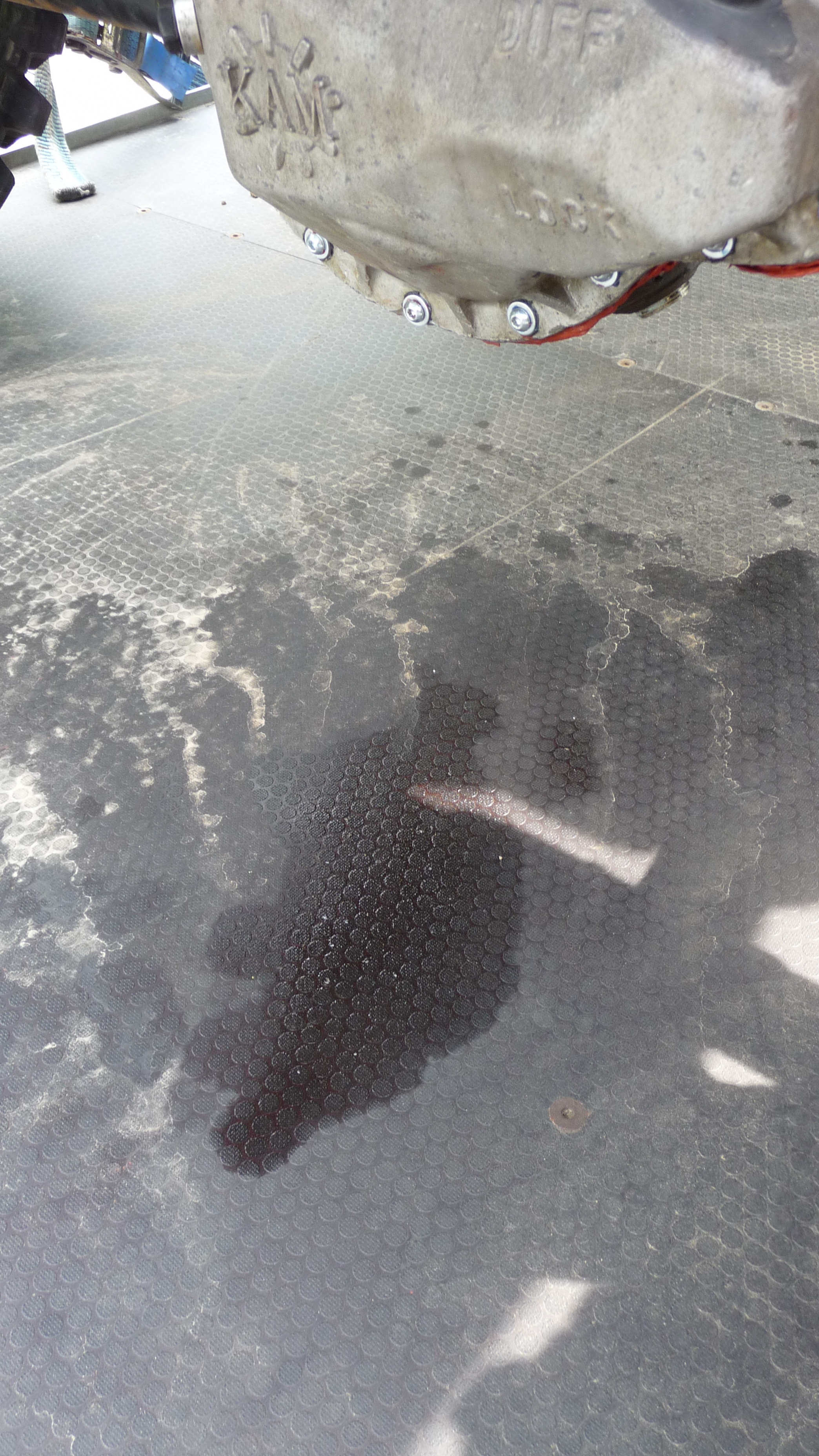

BeitragVerfasst am: 06.07.2009 14:28:49    Titel: Richtigstellung
In KAM Limited Slip Diffs darf EP90 rein! Das war mir (und dem von KAM gesponsertem Fahrer) bisher so nicht bekannt
Die Sperre wurde zwar bei KAM eingebaut aber nicht dort gewartet! Daher ist nicht KAM für die Undichtigkeit verantwortlich. Es handelt sich ausserdem um einen Prototypen.
meine Informationen stammten vom Fahrer und Inhaber des Fzg!

z.guzi
BeitragVerfasst am: 13.07.2009 15:00:27    Titel:
Die KAM Sperere wurde beim Hersteller derselben unterirdisch schlecht eingebaut. Dadurch lag der Deckel nicht plan auf und das Ding war permanent undicht.
Das haben wir mit guter Dichtmasse und dickem Dichtpapier so wieder hinbekommen.
Der Kunde war auch hocherfreut das EP90 in seiner limited slip Sperre drin war....gehört da nämlich nicht rein.....
Grüsse
Peter
Hi in reply to your comments on the forum We viisted your garage Nakatanenga to repair a leak in the rear Diff on our challenge truck on the way to the Transilviania Trophy 2009 in Romiania on the removal of the Diff pan the technitian called over Peter Hochsieder and made comments about the Diff.
I told them I had a spare gasket that kam had given me prior to my trip which Nakatanenga fitted and peter commented that the Kam system was rubbish and would only recommend fitting Detriot lockers.
I have the Kam system on my challenge truck for 24 months and has been used in the UK / France / and most recently the TAT Trophy 2009 in which we crossed the finish line both trucks using the Kam systems 80 trucks started and about 9 finished of which we were part of.
The comments made by Peter Hochsieder form Nakatanenega are quite damming to the Kam products and Nakatanenga being a supplier of Kam I cant understand why Peter has done this as he seems to gone out of his way to cause issues with the Kam systemon the forum.
Nakatanenga charged me 130 Euros to replace a gasket on the Diff and and you can see from the pictures it was still leaking the following day when we got to Romiania we repaired the Diff ourselves.
I think that Peter Hochsieder of Nakatanenga should look at his own quailty of workmanship before passing comments on others.
[img]file:///C:/Documents%20and%20Settings/Compaq_Owner/My%20Documents/My%20Pictures/diff/P1010912.JPG[/img]
It may be interesting to know that Peter Hochsieder is proprietor of nakatanenga
ansonsten hasse ich es hier englisch zu lesen und zu schreiben und die Übersetzung Deiner Zeilen bereitetet mir gewisse Schwierigkeiten - besonders die Feinheiten - wahrscheinlich habe ich übersehen, dass es ein globales Forum ist Unsicher
Die 130 Euro kannst Du sicher zurück fordern - mit Peter kann man immer reden Ja
Ich würde sagen, hier prallen 2 Meinungen zusammen ohne dass ein Dritter dabei war. Ob Peter über Kam schlechtes verbreitet hat, obwohl er selbst Kam Distributer ist, wird er seine Gründe haben ... - die er sicher auch nicht hier erläutern muß.
Weitere Fragen zu diesem Thema bitte an:
Andrew Reid
www.kamdiffs.com
Tel: +44 (0) 1483 419779
Mob: +44 (0) 7815 494798
Fax: +44 (0) 1483 416009
also hier hat er ja seine aussagen auch schon revidiert....als es um die qualität der firma KAM ging..da sind ja jetzt beide einer Meinung Tröst
