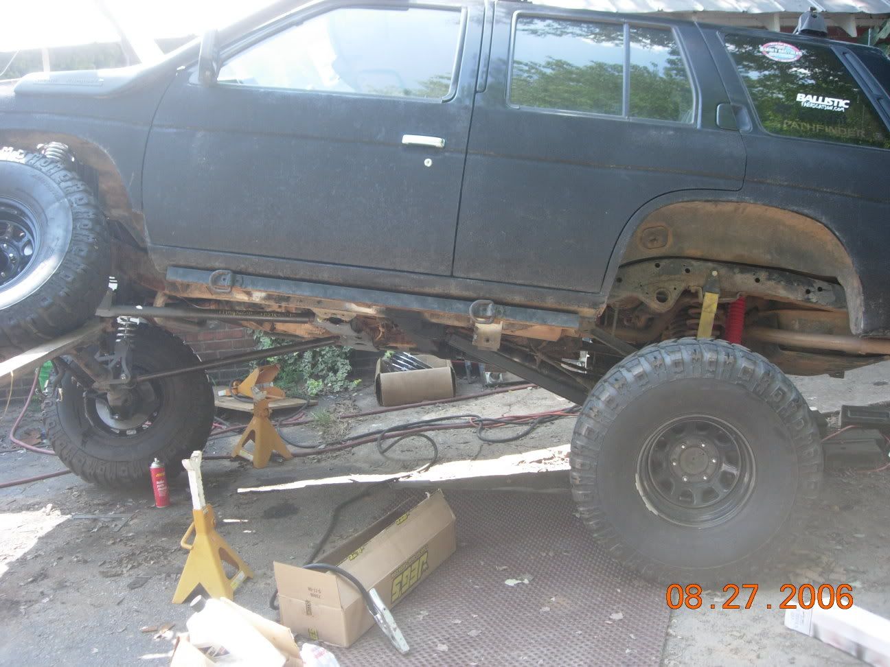

I thought I would try to make a little something on how my nissan was built, I have done a couple major things to it. First I did a trailmaster lift with a Coil-Over IFS set-up. Then I did the long-arm mod that few pathys have over here.

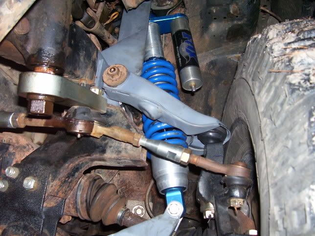

This is the Coil-Over IFS set-up, I dont have many pics of it because there is a pending deal to put this into production. This mod can only be done with a trailmaster or equivelent drop kit.
The reason I did this mod was becuase I wanted a little more lfit without having to use a body lift. And with the drop kit it left the t-bars hanging low under the belly of the pathfinder. As seen in this pic
Wth the Coil-Over set-up I was able to remove the torsion bars and gain some more break-over angle.

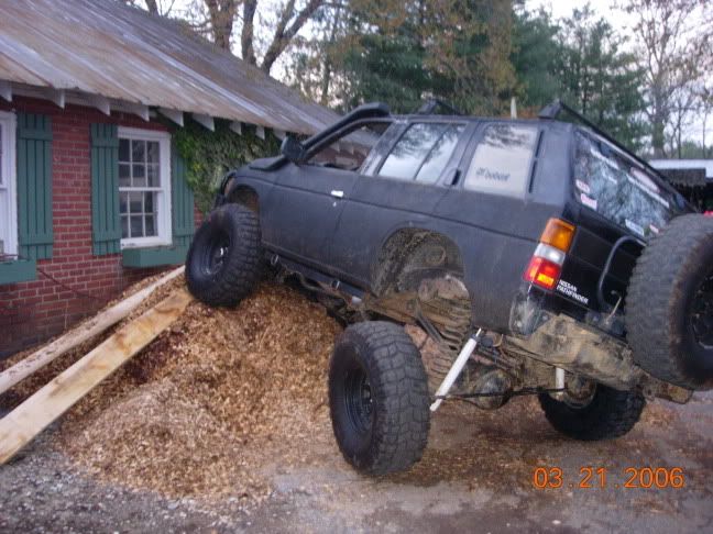

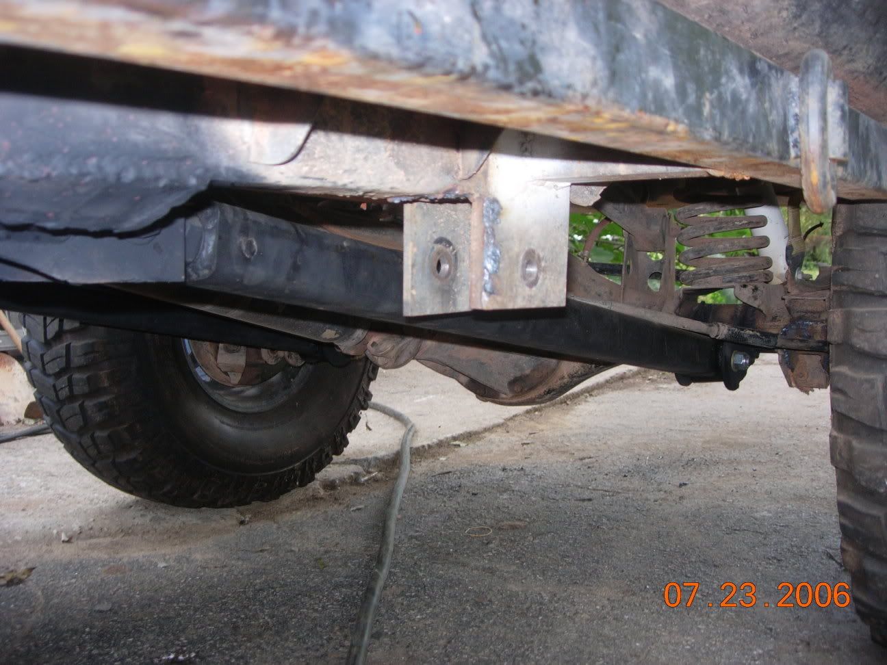

About the same time I decided on the mod for the rear links because my upper links were maxed out with the 7" lift I had. I followed the general idea in this thread
http://nissan4wheelers.com/eve/forums/a/tpc/f/885603133/m/83110436221
It had plenty of travel in the back now.

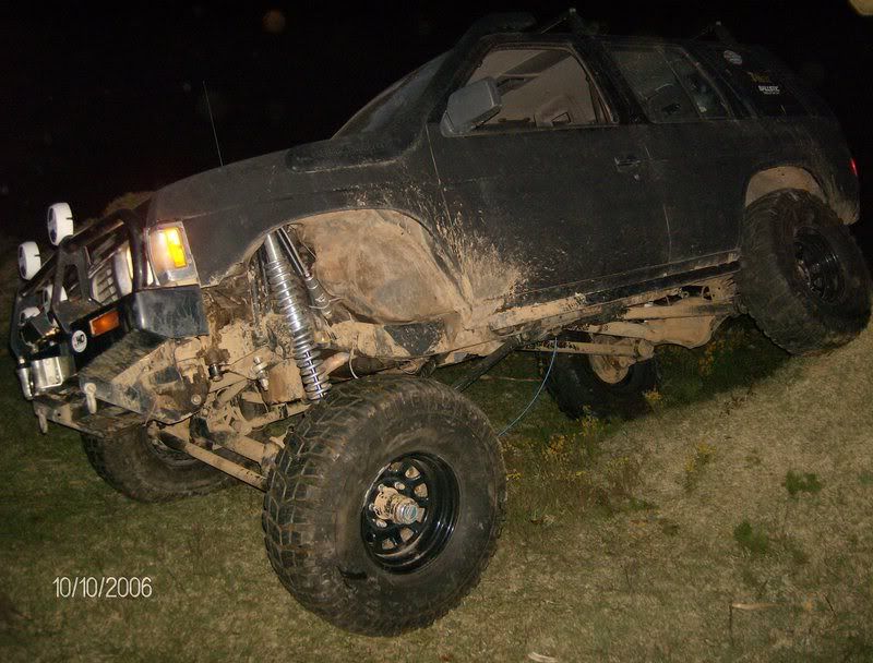

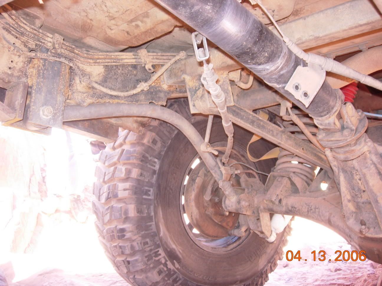

All the mods to this point had been for a project in school, so to test my pathfinder as a final product I headed out to Moab Utah for Easter Jeep Safari. The trip was awesome and the pathfinder did well but I did find some weekness in it. The rear suspension liked to unload going down hill, which mostly just made things a little more hair raising. I found that the IFS just isnt suited to rock crawling, or at least not without much more work. So the whole time I was there I continually checked out other peoples trucks and watched how they worked. On the last day I pretxled the rear links in a dumb way, I had forgotten to build heavy duty ones.
Once I got home I decided an SAS and new rear suspension would have to be built. The first thing I did was replace the old lower links with some beefy ones made out of .375 wall 2" tube with Johny joints.

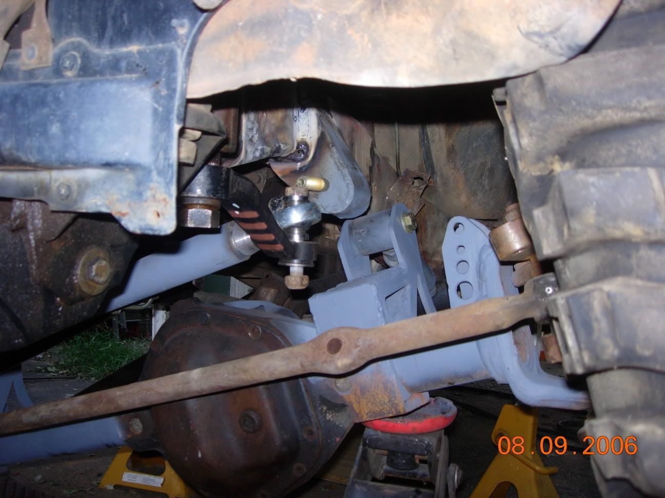

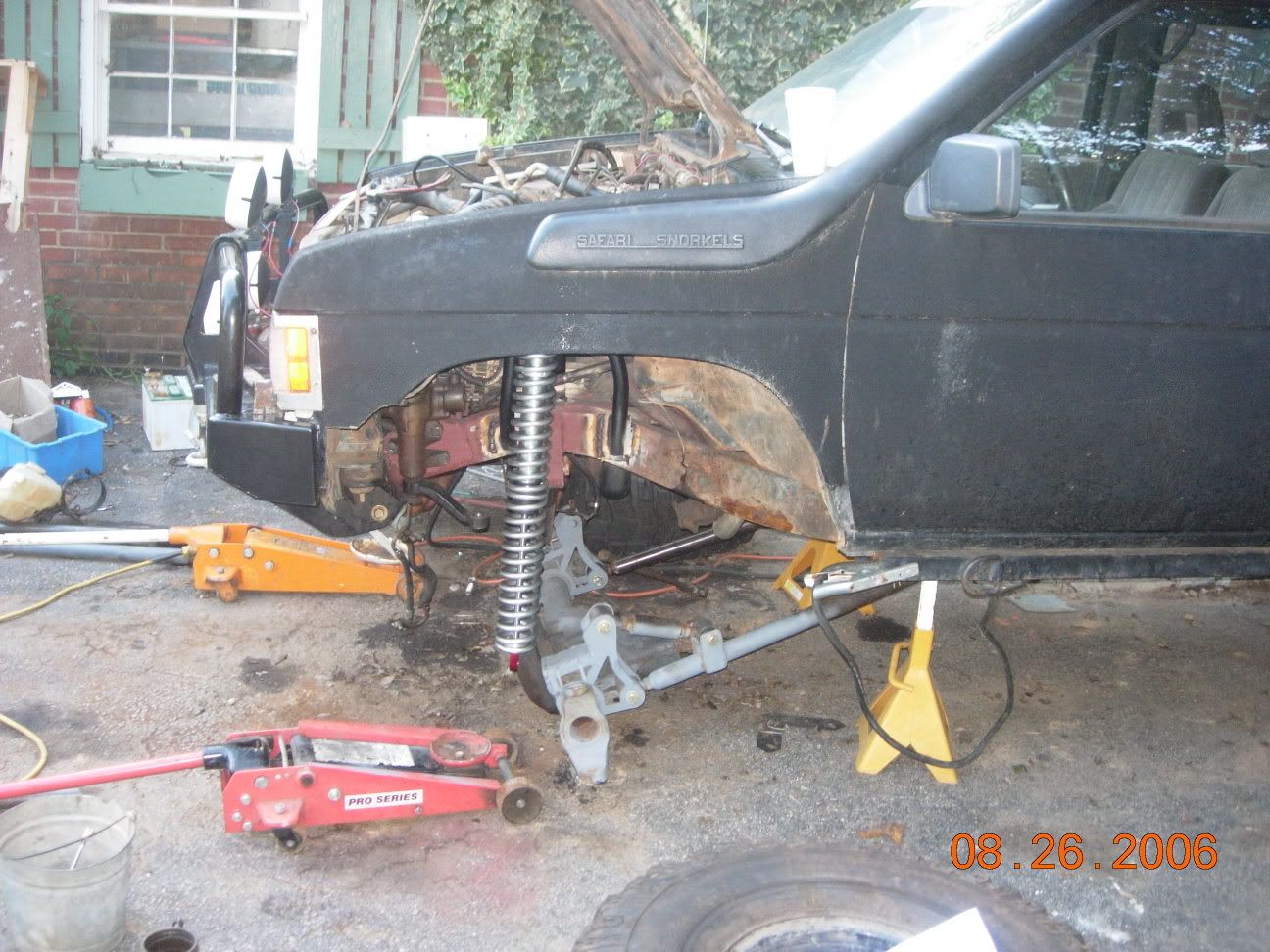

Then I started on the front. I picked up a Dana 44 axle from a waggoneer and cut all my IFS off and started going from there. I moved the axle forward about 4" and gave myself enough room to easily stuff a 39" tire, at least away from the firewall.
I used a radius arm set-up to keep it as low as possible. All links, tierod and drag link are 1.75"x.375 DOM tubing. I used a steering box out of a 1989 toyota 4-runner because I could easly tapp it for hydro assist steering and becuase the nissan one was simply worn out. The 10" Fox coil-ovesr I had before were not long enough for what I wanted so I found a deal on some 14" Walker Evans coil-overs.

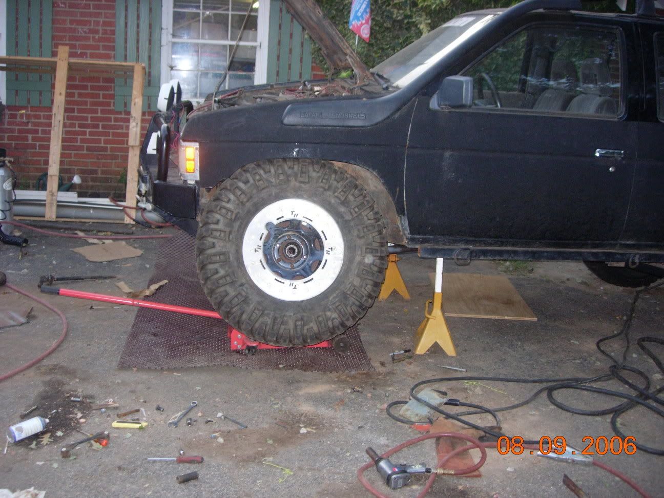

After a couple flex tests showed everythign was good I welded everthing up.
Then the axle got yanked and I built it with 5.13 gears, ARB locker, Yukon chromoly shafts, OX joints with super Winch hubs. I also used hy-steer on this axle.

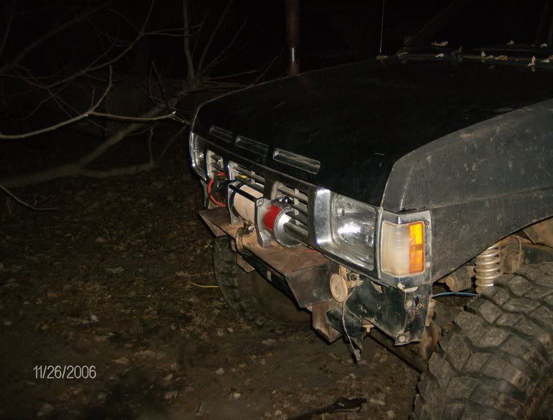

That leads me to today, I decided the ARB bumper was too big and hurt my approach angle so I sold it and I am working on a new Winch mount.
