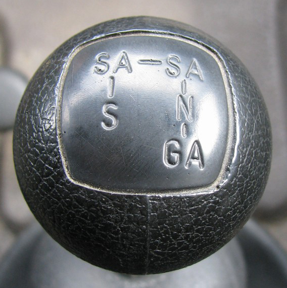

not mention I wonder, what the letters on the shifting lever means:

BeitragVerfasst am: 05.08.2009 14:08:18    Titel:
S = Street (2WD Hi - 1:1)
SA = Street AllWheelDrive (4WD locked, 1:1)
N = Neutral
GA = Offroad AllWheelDrive (4WD low locked)
The letters came from german. GA means Gelände-Allrad and SA Strassen-Allrad.
BeitragVerfasst am: 05.08.2009 14:13:59    Titel:
Anyway - Oil-Specs from older W460 and W461 are equal. Means axles, split-case, transmission (remind the difference between automatic tranny and manual gearbox), steering, braking - all the same. Engine: Which one you got? Just use an oil corresponding to yours. Winke Winke

BeitragVerfasst am: 05.08.2009 14:15:07    Titel:
hello jürgen
s = 2x4
SA = 4x4 high
GA = 4x4 low
N = neutral
G-rüße aus Österreich
Hubsi

BeitragVerfasst am: 05.08.2009 14:23:30    Titel:
N = Neutral
why is double "SA" on the lever? And what means "low" and "hi" in terms of locking?
BeitragVerfasst am: 05.08.2009 14:27:11    Titel:
Jürgen_KSK hat folgendes geschrieben:
N = Neutral
Nope. Means that the split-case doesn´t care, if you pull the lever left or right :-)
Try moving it - There´s no noticable switching action.
Due to no real Differential function, 4x4 Hi and 4x4 Low are always locked. Low means reduction (2.14:1) = more torque, Hi means normal passthrough of power and torque (1:1).

BeitragVerfasst am: 05.08.2009 15:26:25    Titel:
Thank you very much, it helped me a lot! :)
